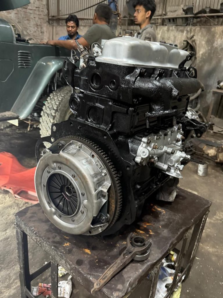

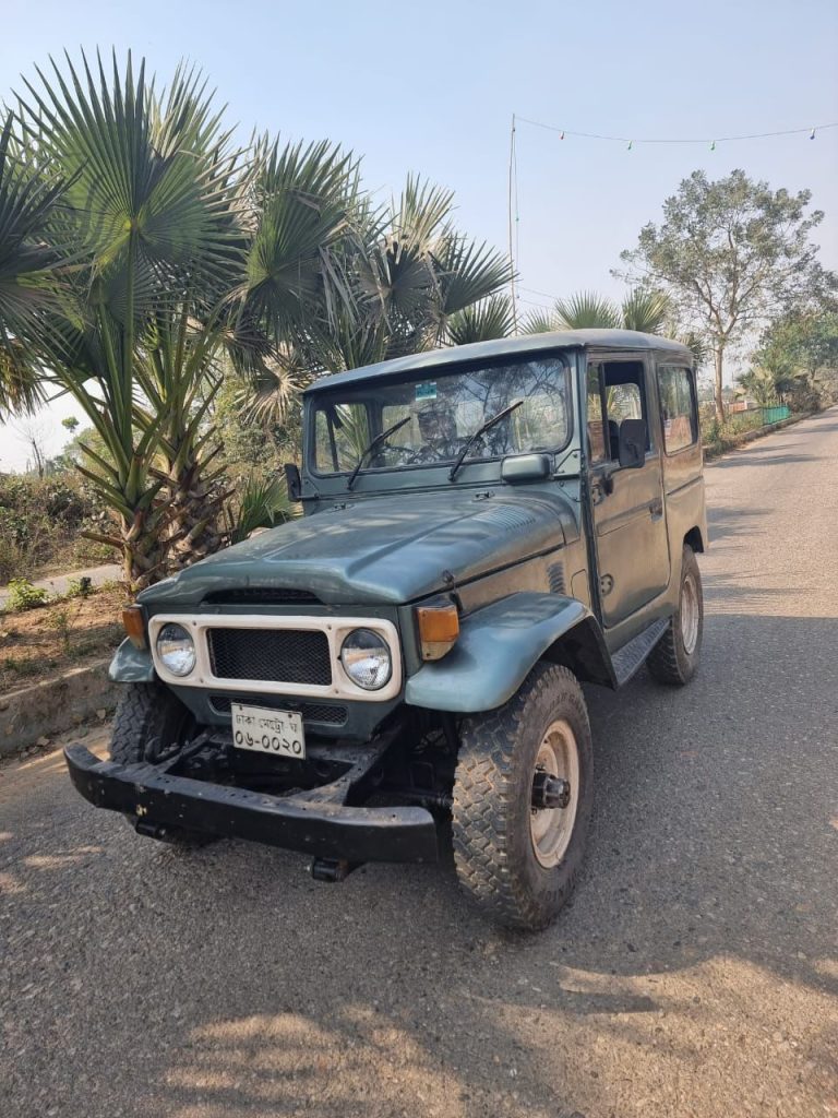

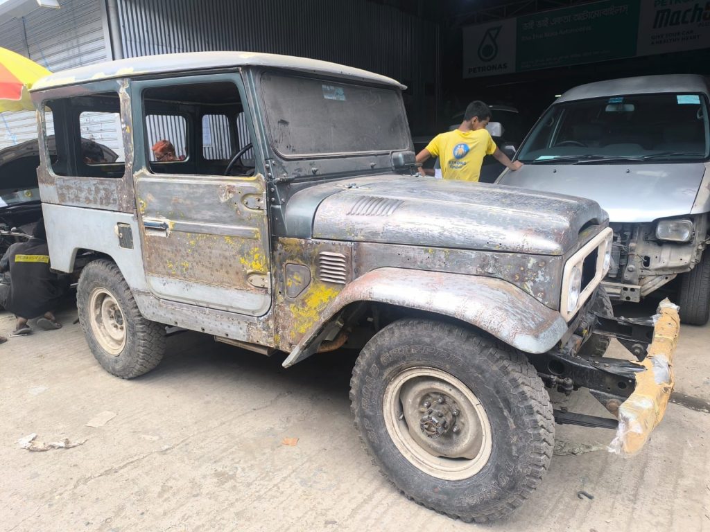

The build kicked off in January 2025 and stretched over roughly a year and a half. The starting point was encouraging—the car was running and structurally decent, though visibly worn. Like many classics of its age, it came with underlying mechanical issues. The starter motor was worn out, and the engine showed signs of burning oil. Naturally, the first phase of the project focused on sorting out these mechanical fundamentals before moving on to anything cosmetic.

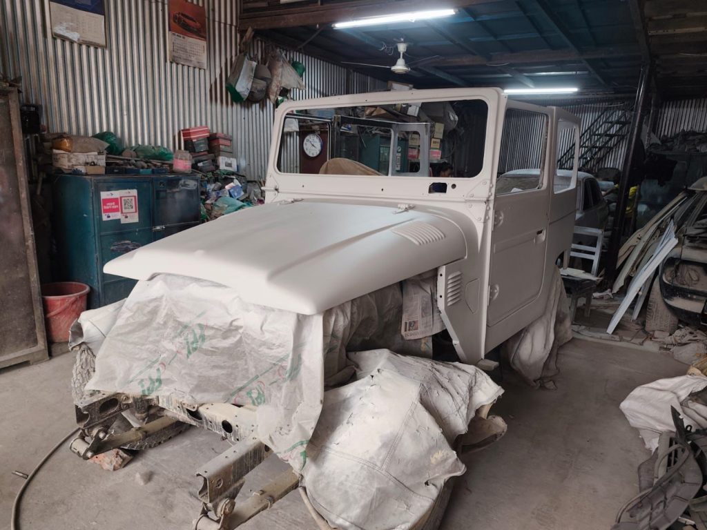

As with most restorations, the real time investment revealed itself in the bodywork. What initially appeared manageable gradually turned into a more involved process, largely due to rust—an unavoidable reality in Dhaka’s environment. Addressing it properly took time and patience, ultimately becoming the most challenging aspect of the build. The work was carried out at a trusted workshop already responsible for maintaining the owner’s company vehicles, reinforcing the importance of familiarity and reliability over experimentation when it comes to local restoration projects.

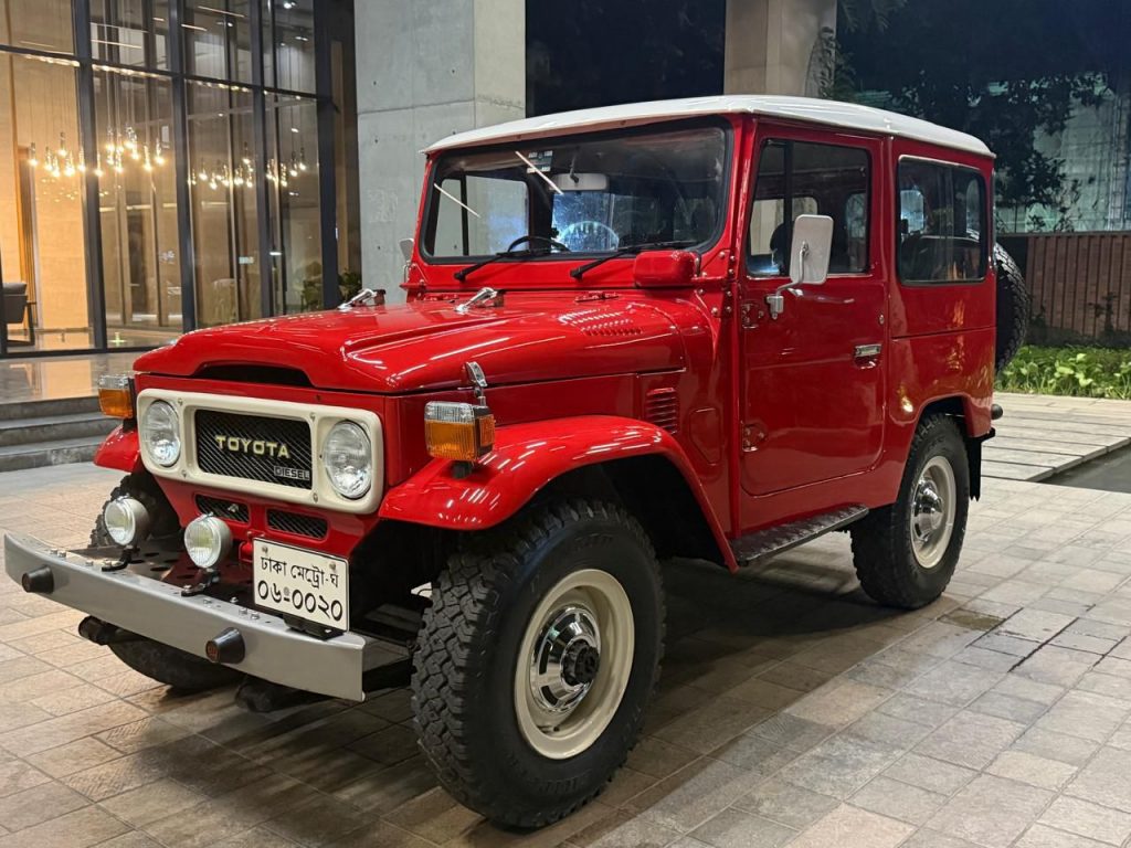

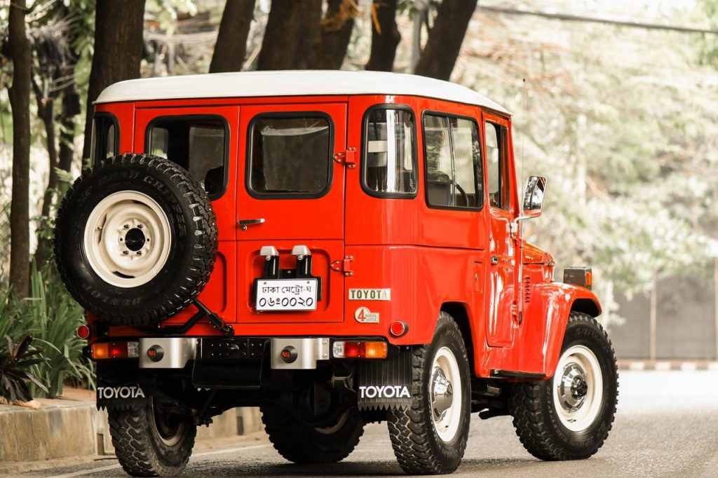

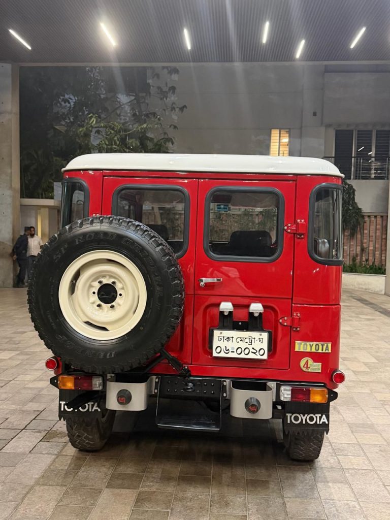

The philosophy behind the build was a careful balance between preservation and usability. While most of the original mechanical components were retained, key upgrades were introduced to bring the car closer to modern driving standards. The suspension was upgraded using an Old Man Emu setup, while the braking and driveline systems were enhanced with components from the 70 Series platform, including an upgraded differential. Air conditioning was also added—an essential improvement for real-world usability in Dhaka.
Sourcing parts highlighted a common divide in the local restoration scene. Mechanical components were relatively easy to find within the country, but cosmetic elements told a different story. Accessories, trim pieces, and especially rubber seals had to be imported, often at significant cost. In fact, it was these smaller, finishing components that turned out to be some of the most expensive items in the entire build.

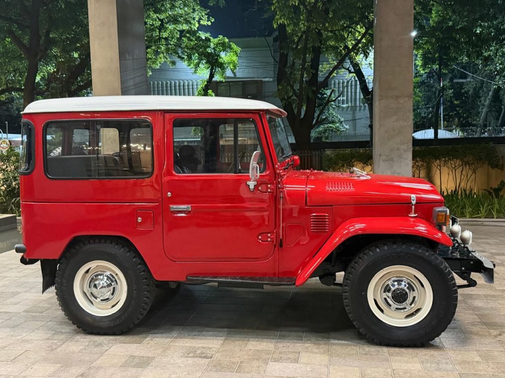

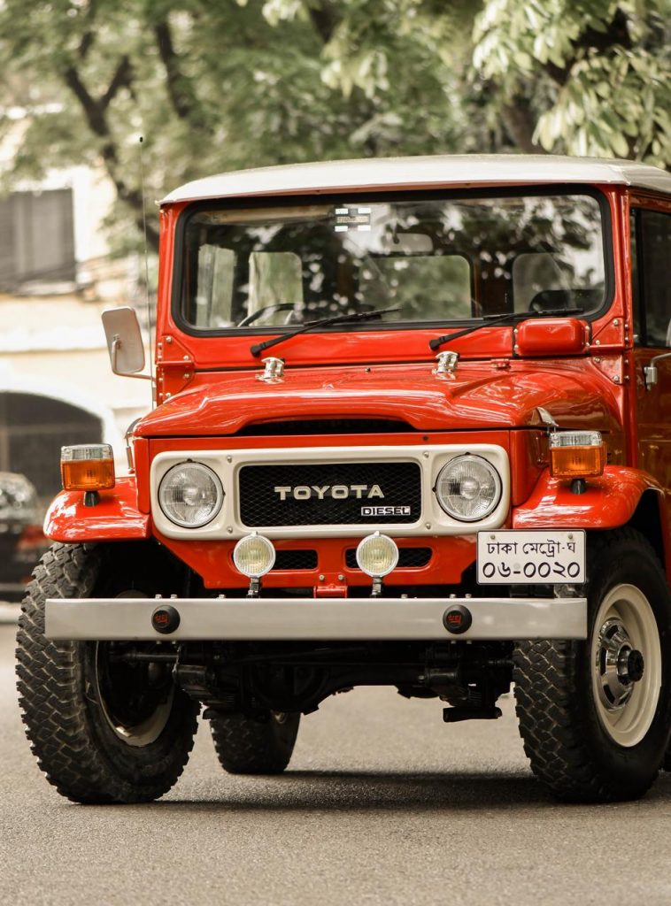

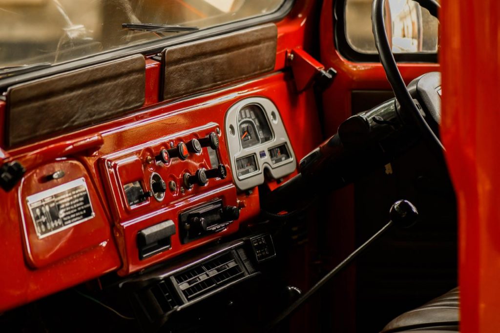

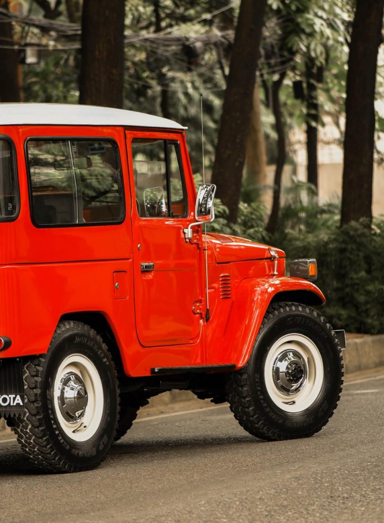

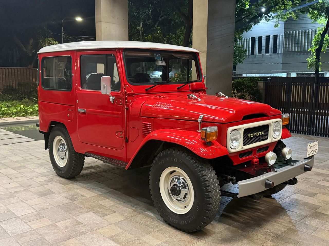

Visually, the final result reflects a deliberate mix of restraint and presence. The overall aesthetic lands somewhere between classy and slightly bold, without tipping too far in either direction. Much of this balance comes down to the details. The badges, in particular, stand out—not because they are flashy, but because they tie in seamlessly with the wheels and grille, completing the look in a subtle but effective way. Still, the defining element of the build is the paintwork, which brings everything together and delivers that “factory-fresh” impression the project set out to achieve.
