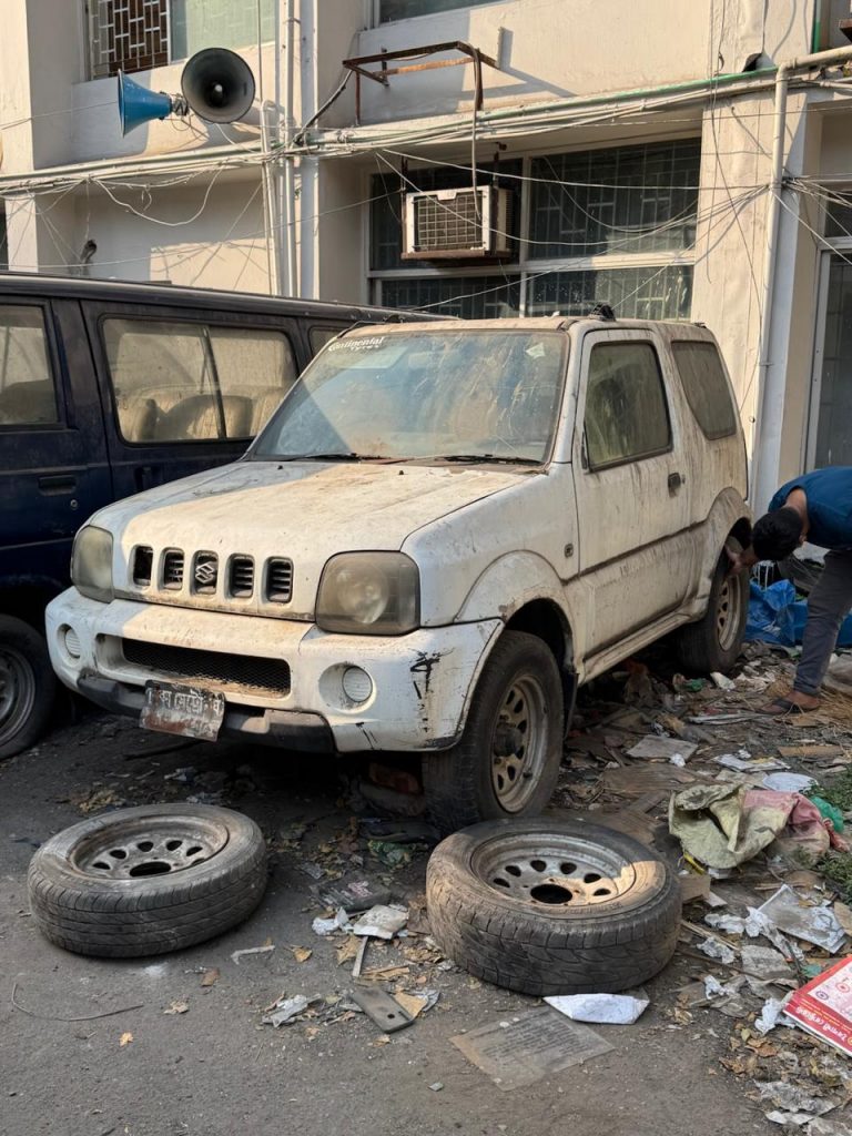

This 2003 JB43 — powered by Suzuki’s dependable 1.3-litre engine — began its life not as a lifestyle accessory but as a government workhorse. It served under the Government of Bangladesh in the Ministry of Health pool fleet.
For years, it travelled across the country — city traffic, rural clinics, pot holed backroads — carrying officials, files, and responsibility. It was never pampered. It was used.

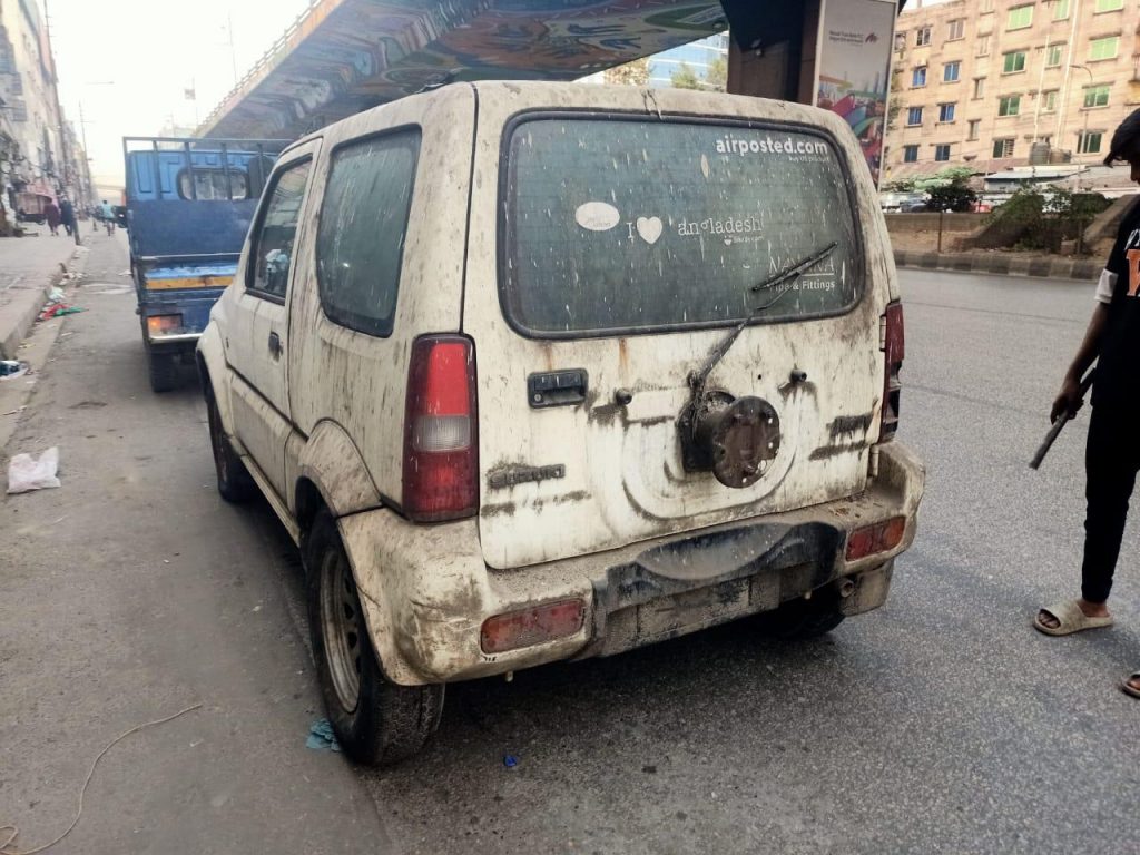

Like many pool cars, maintenance was functional rather than thorough. When engine issues began to surface, the decision was simple: retire it from active duty. By 2025, it was put up for sale in a government auction — tired, worn, and mechanically unwell.

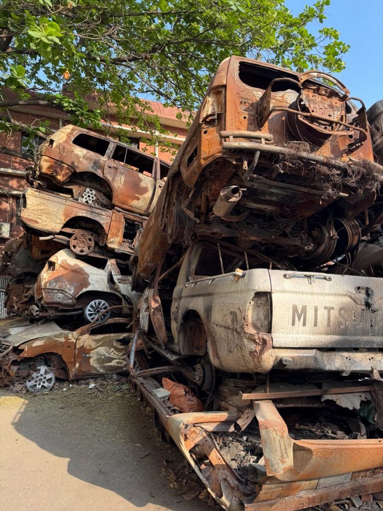

During the unrest of the July ’24 revolution , vehicles stored around it were burned to a crisp. Rows of metal reduced to twisted, blackened shells. Yet somehow, this tiny Jimny remained untouched. Smoke-stained, surrounded by wreckage — but alive.
Where others saw a forgotten relic, Motorwerks saw a rough diamond.
Burnt out ex-govt pool cars

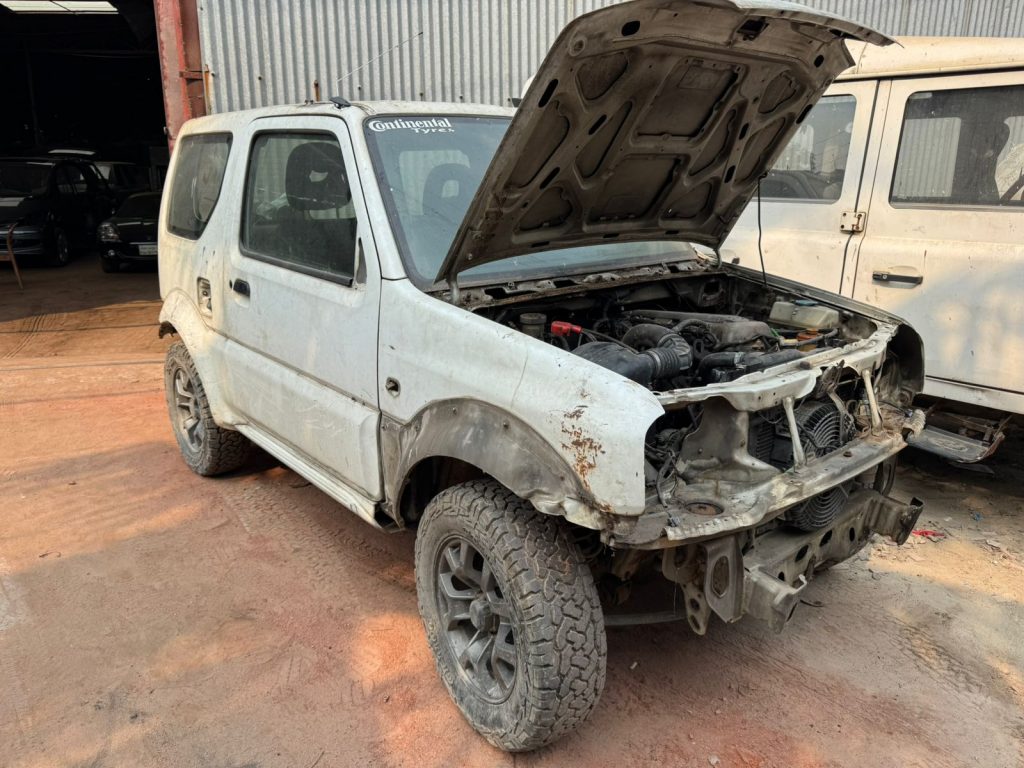

Jimny being towed to Motorwerks

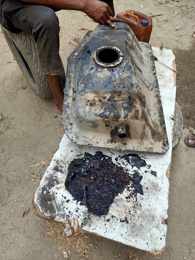

This Jimny came equipped with the rare JB43W 1300cc twin-cam M13A petrol engine which was completely rebuilt — stripped down, inspected, and refreshed with care. Worn internals were replaced, seals and gaskets renewed, tolerances checked and corrected. The goal wasn’t just to make it run. It was to make it dependable again. The fuel tank had accumulated years of debris and contamination — the kind of neglect that quietly compromises reliability.
Tar and debris cleaned from the fuel tank

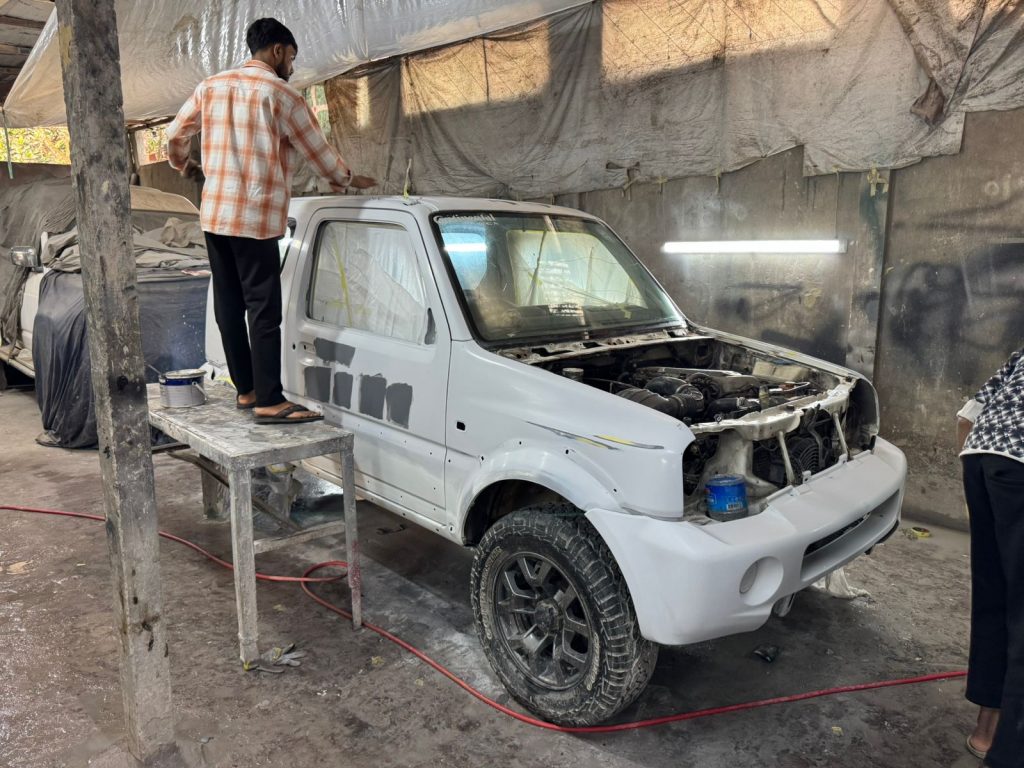

Years of government duty had left their marks. Dents, tired paint, and surface fatigue told its story. The Motorwerks paint team stripped the body back and began the slow process of restoration.
The brief was clear: OEM+.
Not flashy. Not overbuilt. Respect the car’s original character — elevate it subtly.

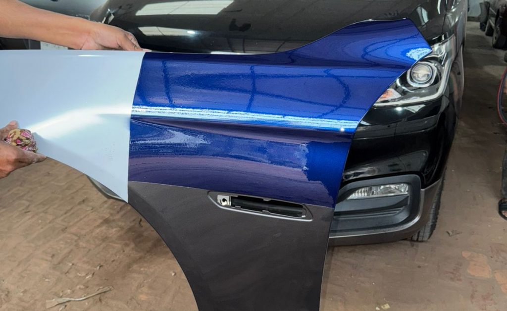

At the bodyshop
The chosen finish was Gentian Blue, a shade borrowed from Porsche 911 palettes, paired with Toyota’s Magnetic Grey as a contrasting lower tone. The two-tone treatment transformed the car while remaining tasteful.
Paint samples
The result is striking but mature. It looks factory — if the factory had better taste.

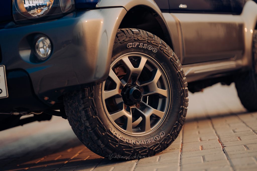

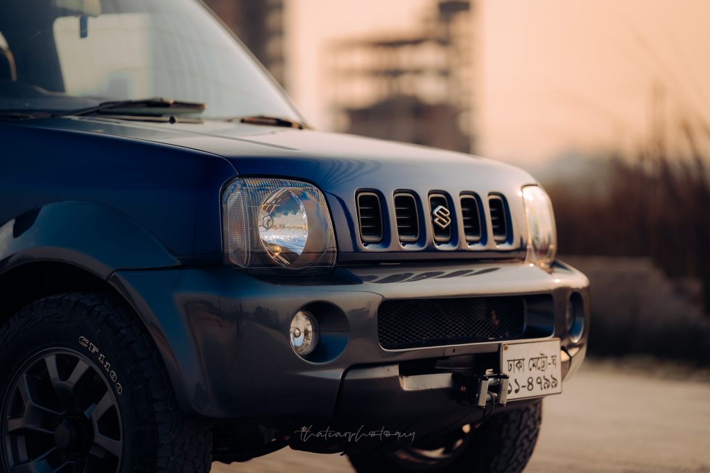

  • Wheels and tyres from the latest-generation Jimny — sourced from a friend who upgraded their new car — gave it a wider stance and a more purposeful posture.
Brand new headlights freshen up the front end
Wheels from the 4th gen JC74W Jimny with new tyres
And then, luck intervened.

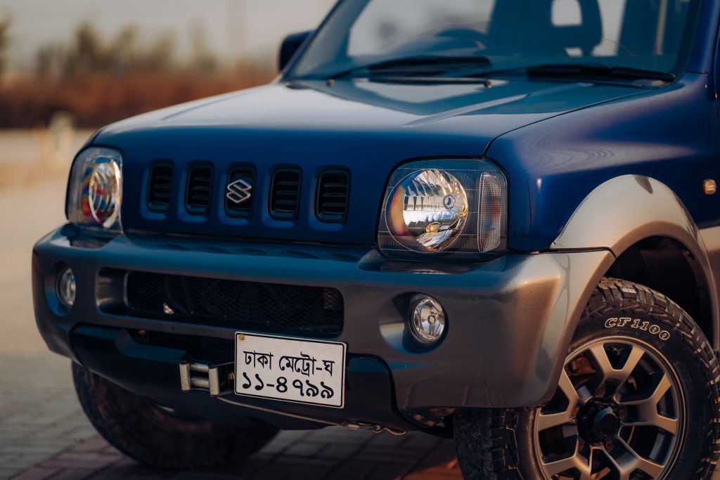

A winch — found locally at an auto parts store — surfaced at just the right time. In a market where sourcing can take months, this was a lucky find. Fitted neatly up front, it completes the transformation from restored classic to functional explorer.
Winch added for off-road practicality, which meant the number plate had to be put off centre

Wider wheels and tyres enhance the stance
